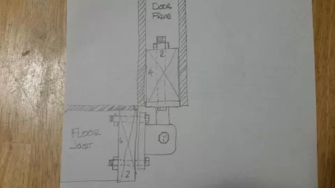

    So after a recent reassessment and hike in real estate taxes, I am determined to utilize every inch of my modest .53 acre lot. I already moved all the brush and tree lines back to within inches of adjoining properties. The last unused area is at the NW side, so I have cleared that area and restored the original grade which was designed to carry around the house foundation and into the front yard where the grade is sloped significantly toward the street. Now I want to build a 10 x 8 shed to house the tractor and yard tools.
    I'd like to have a door on one end that i can pull down and drive the tractor in. Is there piano hinge type hardware strong enough to hold a 6 x 8 3/4" door? Or should I just use many regular hinges?

  5. infinitymike
    infinitymike
    Aug 23, 2011
    1,833
    591
    Long Island, NY
    You could use this.
    http://www.hardwaresource.com/hinges/SPECIALTY+HINGES/Heavy+Duty+Hinges/Heavy+Duty+Gate+Hinges/Heavy+Duty+Bolt-On+Hinges%2C+Stainless+Steel
    Right now the picture shows the two plates parallel to each other, thru bolt the left plate to the shed framing and turn the right plate up 90* and thru bolt it to the bottom edge of the door.
    I assume it is 6 feet wide by 8 feet tall and 3/4" thick?
    I would make a 2x4 frame on the flat (1.5" thick) and then skin it with 3/4" plywood on both sides.
    So the total thickness would be 3".
    Looks like those hinges are 1.5" x7" so the 1.5" hinge plate will line right up with the 1.5" edge of the 2x4 frame.
  6. infinitymike
    infinitymike
    Aug 23, 2011
    1,833
    591
    Long Island, NY
    Like this

  8. infinitymike
    infinitymike
    Aug 23, 2011
    1,833
    591
    Long Island, NY
    I drew that wrong, sorry.
    You wont see 2 bolts on the plate mounted to the floor because the are in line and centered.
    It should look like the part that is mounted to the door frame.
    Also with this hinge and mounting detail you won't have to worry about dirt binding the door buit you will have a 3.5" gap between the door and the floor when the door is opened
