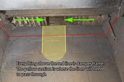

    Once the steel is cut away then there is not that much fire brick that needs to be cut for a 6 inch liner. from what I see.

    It looks like you might be able to just raise the left end (away from the lever) of the damper, and thereby get enough clearance to get the lever end out of its hole in the frame so the damper can drop out. Both damper and frame appear to be cast iron, and they certainly weren't cast as a complete assembly. They have to come apart somehow.
    With appropriate blade changes an angle grinder can cut both the cast iron and the brick. A diamond blade will go through brick almost like butter, but I don't envy you the job; cutting brick makes an enormous amount of dust. You'll have to tent the area and wear goggles and an excellent dust mask or respirator, and you'll still end up with some dust escaping into the room.

    When I removed mine I had to use a long blade on my reciprocating saw. It looks like you should be able to get at it pretty easy. Just cut the pin on one side and push it up and pull it out. Maybe I can't see what you see, but it looks like it will fit with minimal brick cutting. Like what was stated, the grinder will cut the brick easily.

    Thanks all. I'm confident that an angle grinder will go through the bricks easily enough now. Should I be worried about what's behind those bricks, though? I will be installing a block off plate, likely made from 22 or 24 gauge steel. I assume that as long as the block off plate covers the whole I carve through the bricks, it should be safe, right?

    Removing bricks would probably make covering with a block-off plate more difficult than it would be if you limited the demo to the damper area.
    A flex liner will make a 90° curve, but I doubt that you will need to do anything like this. I did it to reach the rear flue of my stove out on the hearth. An insert's flue is in the top of the unit; looks to me like your liner may have to make a shallow "S" to reach the flue of an insert, but that's about it. No reason to remove a bunch of bricks.

    Maybe you said upthread and I missed it, but what are the interior dimensions of the chimney? In the shot with the yellow cutaway area drawn in, it looks pretty tight side-to-side above the damper.

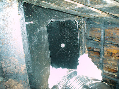

    I had too chip out a few inches of fire brick for a 8 inch liner after cutting damper frame but it was easy to seal up tight with the white fire insulation and my home made block off plate. Look at the third pic and you see that I had same sloped firebrick problem and I installed 8 inch easily

    I think that photo makes it look smaller than it is. I have not measured the interior dimensions. The exterior at top is 11.5" x 11.5" and the tiles are only maybe 0.5" thick at most. I'm guessing it's at least 9" wide throughout. I'll be using a 6" liner with 0.5" insulation. It may have some trouble navigating the part in the middle where it turns to one side, but I think with liner pulling cone I can get it through pretty easily.
