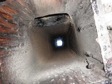

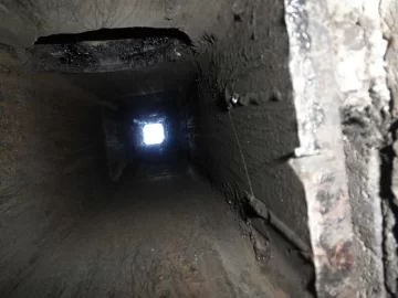

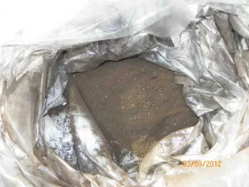

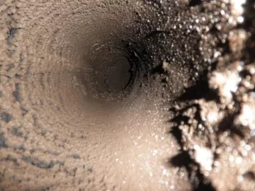

Since we had warmer weather this year we changed our burning habits for about three months (burned cooler stack temps) we will never do that again. Most of the chimney was the same except for part of the section (about four feet down from the top) the good thing was it was all fluffy ash.

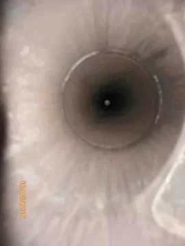

Thie screen up top looks good but this summer I'll get up on the roof for a better look plus clean it. The Liberty is going back to burning at 600-650 which should take care of most of the problem.

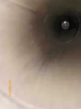

The first two pictures are before the cleaning. We also use anit creo soot spray which turns any buildup to a fluffy ash so cleaning is easier.
