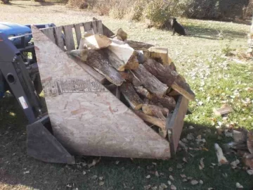

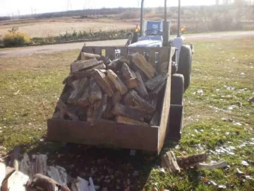

This spring I finally got around to putting a simple wood hauler together for moving wood around on the yard. This afternoon I started moving wood around to where it can go straight into the house. It is a pain in the rear end moving wood around but we have made it easier by building this simple two pallet and 2 triangles of OSB I had laying around. We have had to patch it a couple of times but we can put a fair amount of wood in it and given that it is on the front end of the tractor we can get it into some pretty tight spots.
We are having to move some of the wood around because we are working to expand our backyard rink. If I had my way all of our firewood would be moved to the corner of our house at this time of the year so we didn't have to use the tractor to move the wood around later. It is actually getting interesting now that we have wood cut and split through to the end of 2011-12. We aren't able to just put it any old place as we have to plan for accessing the wood in the proper order.

I like it. Moving any real quantity of wood with the 5' bucket on the Ford gets old. Put another one on the 3 pt and you will be able to keep the rear wheels on the ground.
We are thinking of putting some sort of pallet fork on the three point hitch for exactly that reason. Right now we leave either the cultivator in the summer or the grader blade in the winter on the three point as a counter weight. We have also learned, the hard way, to keep the load reaaaal low when we load it full. It also depends partly on the type of wood we are hauling. Tonight I pushed it a bit because it was shoulder season-bordering on punky elm. I need to get it out of the way not only for the rink but for stacking the wood we split last weekend.
