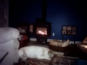

njtomatoguy said:Heres a pic of my stove installed with single wall pipe.
What are you doing for the ceiling kit?
Lowes?
I have a cathedral ceiling and had to special order a kit.
Single wall is cheap enough not to worry about replacing it every few years for me.
