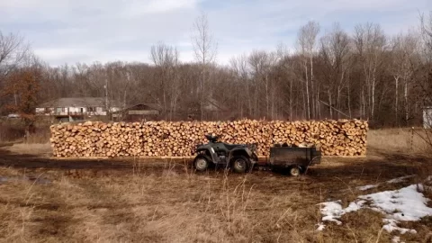

I burned a bit of pine last year, and ran out, having to stick solely with hardwood. I missed it. Pine made starting fires so much easier. Here in MI, the rumor runs rampant as well, and I was told that if I was going to burn pine, it had to be seasoned for at least 4 years to get the sap out. The creosote horrors! ;hm
Anyway, this year I decided since I missed the pine I DID have last year, I'd get more. Here she be, two rows deep. All pine. Hoping to burn it in the fall.IMG_20150315_165316905.jpg
