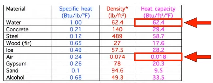

If you store the energy in a tank of water you could provide DHW also. Here is a chart that shows the heat capacity of various materials. It was used to show the difference between forced air and hydronic heat. But you can see how sand and concrete stack up against water.

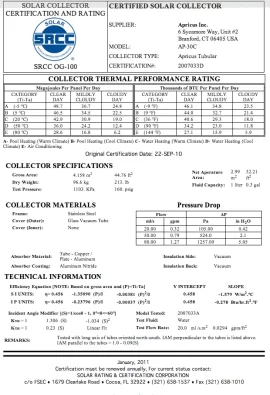

Also an output sheet for a common 30 tube array of evac tubes. On the right hand side notice some performance under different solar conditions and different operating temperatures. Category C or D and clear or mildly cloudy day would be close for that area. So expect between 23 - 40,000 BTU per DAY. Per day not hour!
So with 3 - 30 tube arrays maybe 100- 120,000 btu/ day.
2300 square foot of shop with a reasonable load at design of 30 btu/ sq. ft = @ 70,000 btu/ hr load. So on design days you would be able to provide about 1-1/2 hour or so worth of energy, with 90 tubes.
Granted you will see many days above design conditions and certainly some milder days where those 90 tubes will cover the load.
Of course you just need to supply temperature above the slab and ambient temperature in the shop. By driving those collectors at 80 or 90F supply you increase the efficiency. Really no need to drive them at high operating temperatures if 80 or 90 will add energy to the slab. That is what those different categories on the data sheet are showing you.

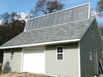

Here's my solar shed.The collector is based on Gary from http://www.builditsolar.com/ design.Copper tubing with alluminum flashing.Collector area is about 5ft. by 28 ft. Shed is 20ft by 28ft. so not a big building. The collector feeds a 200 gal. storage tank(also Garys design).The tank also has a copper HX that the boiler feeds. The floor has 2 loops of pex in it.
I keep the temp in the building at 50F to 55F. I estimate after 2 winters now that the solar covers approx. 50% of the total heat load so I'm happy with it.
I think if you used the concrete for storage it might not work as good because after 3 or 4 days of no sun the slab and building would cool down so far that you would have a hard time regaining decent temps again.But even with water storage you need an alternate heat source.So---I don't know.
I do know that my building keeps up temp with solar only from the start of the heating season till the end of november,after that it requires imput from the boiler.Of coarse it depends on how cold outside temps are too and how much sun you get ,so lots of variables.
