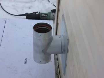

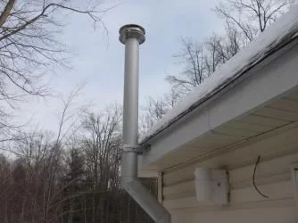

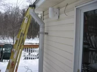

Take pics of the piping and post them.
I only have ONE 90 and that's the T cleanout and ONE 45. No draft problems whatsoever.

Pretty sure I can see two 45's in your pictures................???
OOPS! You're right, but that's acceptable.
