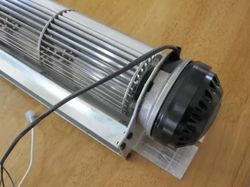

    If the unit was shipped from the Enviro warehouse? There is a good chance its up to date with enhancements. But if your dealer had it in his own stock? Could have been over looked by your dealer.
    If your unit has this convection blower(see picture)? It is the old version and should be updated with the new one to reduce the #4 flashing error. Also check your auger cover plate. It should have slots allowing adjustments to reduce feed with high BTU fuels.

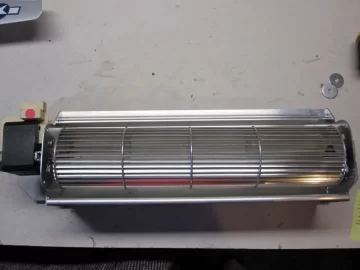

    New blower looks like this.

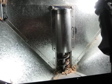

    The original cover looks like the picture. New one has slots to adjust it up or down to control pellet flow. Sorry I don't have a picture of the new one. Maybe a M55 owner can snap one for you?

    I don't remember mine being so open I'll look tommarrow when the pellets run down thank you for the picture.

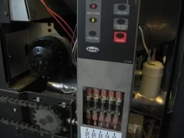

    So indeed, my M55 has the old style convection blower. When looking at the picture posted in this thread, I can clearly see that the motor drive shaft and the squirrel cage are misaligned probably due to the weight of the motor.
    In my case, it causes a major alternating sideshift (like moving left to right every 2 seconds when heating on #3 setting). And at some point, it simply quits turning thus triggering the high temp limit switch.
    When trying to heat at #4 and #5 settings, I get friction noises and not just the little thing: a real annoying and "about to fail" kind of noise.
    So I took it apart, I unclipped the motor from the blower and rotated to motor 90deg CW (when looking from the control panel side). Then, I installed a little piece of wood between the motor and the steel frame of the stove, which brought alignment back to normal.... for a January 1st!!!

    My problem with convection blower on my M55 is solved. Sherwood Industries (Enviro) replaced my blower free of charge even though I was a good two months passed the warranty limit (original purchase in mid october 2009)
    Thank you Sherwood!
    Here is how it looks after it's installed:
    In terms of noise, for me it ooes seem slightly louder, but it is a sound of air flowing through the tubes. The number of days I need to heat at 4 or 5 being so limited, it is no big deal.
    I do recommend anyone having an issue with a flashing #4 light to not hesitate to install this new style blower.
    By the way, instructions provided by Enviro were super clear and very easy to follow. Well done by Enviro!
