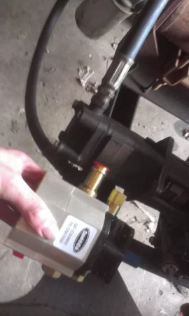

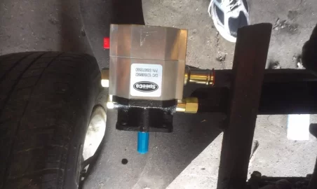

    Well I finally found time to pull the old pump today and discovered the love joy coupler and mounting bracket do not fit the new pump. I purchased the new pump via ebay and go figure still in plastic unused BUT NO DIRECTIONS. :confused: I contacted SpeeCo and they have not responded yet ( 3 emails in 2 weeks 4 calls no answer ). Do any of you have one of these pumps ? What size love joy coupler did you use ? Where can I get a mounting bracket for it as well ? I could fab one up if I need to but time is an issue right now. ( Edit ) I can drill mounting holes in this bracket so thats solved.
    Thanks everybody
    Pete

    Hard to tell from pictures
    You need the diameter of the shaft on the engine & pump.
    Then get a matching love joy coupler body the right diameter . Granger has them

    Pete - you should only have to replace one half of that coupler. The pump half. There are basically two sizes of lovejoys (based off of HP ratings) and then the shaft size. In other words...If you have the small coupler - then buy the other half of the "small" size to fit the pump shaft. The coupler should be able to slide back and forth to adjust for the proper fit.

    The bolt pattern for the pump is standard and should not require drilling. A new suction line will be needed because of the barbed fitting on the pump.Two different shaft sizes are used with that size pump either 7/16" or 1/2". Most farm supply stores will carry them.

    I thought that would be the case but the holes don't line up. I am gonna try farm and home this weekend they have more than TSC usually. Thanks for the heads up on the line I noticed that too but haven't really had time to look at it beyond that.
