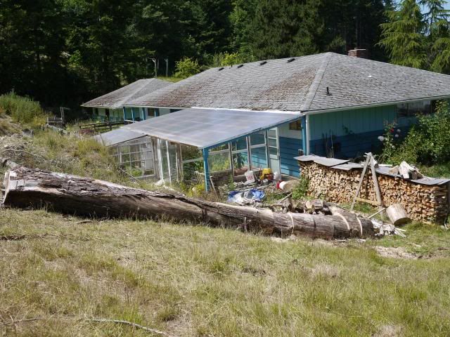

    Oh, and Scotty, man, if I had hydraulics this thread wouldn't exist. It would all be done. I've c/s/s an honest one and a half cords from this one tree already. Maybe another 1/2 and change to go. Here's a pic of one of it's three trunks....
