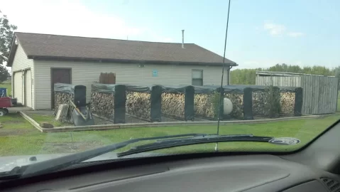

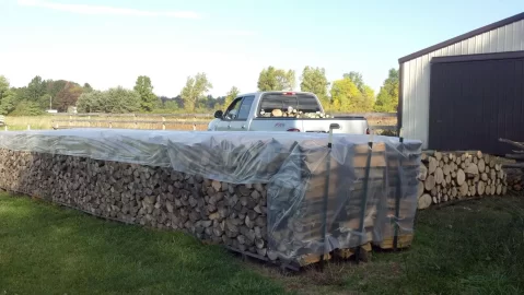

I have single stacks up behind the garage and a large storage area back by my Barn. Where there 3 wide and almost 1' ft apart.

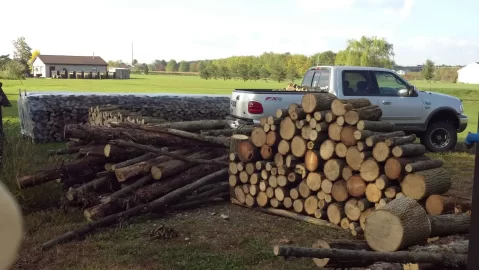

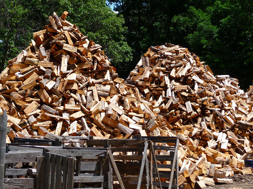

I'll try to get a better pic today.
It looks some thing like this.
Sean
Holy chit! You've got some stacking to do! I've got 25 cord, split-stacked-seasoning........stacking not only makes it look nicer, but allows it to season alot better.
Those are some awesome looking piles...Lots of stacking to do.....@ PapaDave thats hilarious!
Lol teepee? We call that a pile around here and if you don't stack it soon it's going to be a compost pile in the bottom. Try to at least get some of it stacked and top covered, don't cover those heaps with poly it will trap all the moisture in and block the wind out. Good work on getting a lot of wood but don't let your hard work go to waste.
Yeah. Thats no Tee-pee. Thats a pile. Will not season very well. Also, make sure the wood is not in contact with the ground. Lay on skids, boards, landscaping timbers, etc.
Reactions: Backwoods Savage
Holz Miete . . . and double stacked rows on pallets. Season outside for 1-2 seasons. Place in woodshed for 1 season. Burn in Year 3 (sometimes Year 4) for some primo fuel.
Reactions: scotvl
Just seeing if you guys are on the ball or not!
Ya there just a pile, not even mine!

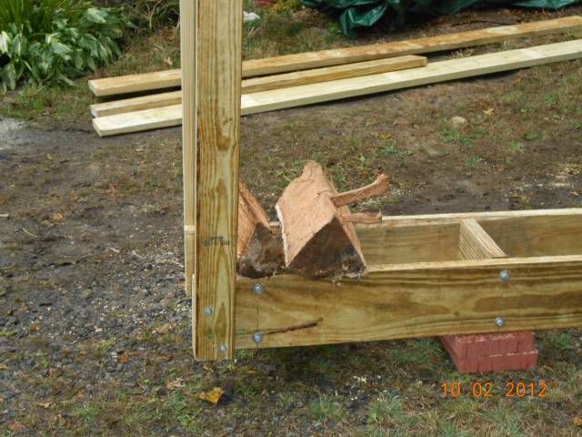

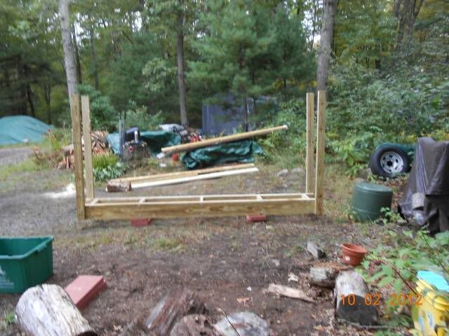

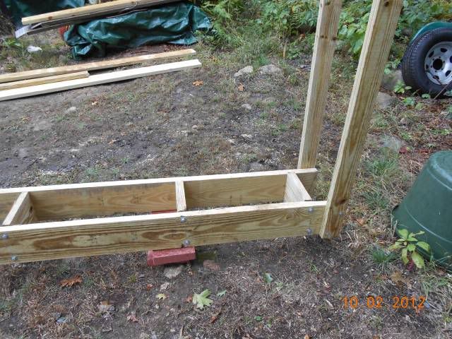

So if I make some racks out of 2x8's 12" apart,set on pavers- that should work , ?
Why two rows?
I already have 4 stacks for this season!
Sean
Here is what I'll use!
What do you think!
Sean
I would add a board to the top. Its gonna keep them from bowing out. My stacks all have plastic on them, but if you look in my pics above, you can see how straight the tops are (stacks with black plastic on top/8 single rows). I ran a small piece between the end uprights and then a 12' 2x4 from upright to upright.
Those look awesome and will help the wood season much better than in a "Pile/Tee-Pee". LOL
shucks dexter, talk about some precision piles....i don't think one stick is out of place or not flush with the rest of the pile. nice job.
sean, that must cost almost as much as a cord or wood....but it will last and keep it up off the ground. now that i think about it, i might have some old decking i could use.
cass
Reactions: DexterDay
sean, that must cost almost as much as a cord or wood....but it will last and keep it up off the ground. now that i think about it, i might have some old decking i could use.cass
Home crappo had 2x8x10 for $12+/- and 2x4x10 for $5 all Pressure treated!
So lets see 2 racks = 5@$12 = $60 add the 2x4's @ $5 each = $70 +/- easy to stack with the uprights!
OR 6x6x8 for $20 +/-
2 Racks 4@$20 = $80
Note only 8'
Forgot some 3/8 galvy lags and washers !
Not much diff?
So why not!
Sean
Wow I feel pretty inadequate now! I just stack on longer thinner logs to keep the wood off the ground. I'm too lazy/cheap to put together racks like that! Looks good but agree that a board on the top will keep it from bowing out.

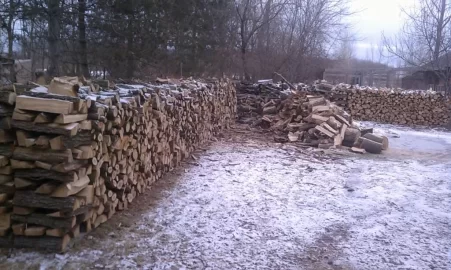

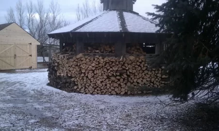

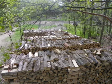

Here's my setup, rows outside and 2 plus years worth in the round barn. Wish the barn had more overhang tho. :)
