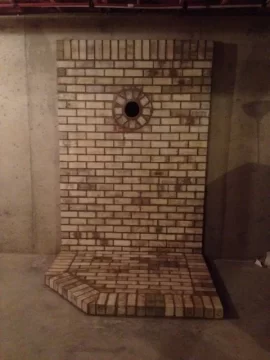

I recently had a brick hearth/profile built and wondering how close I can put my stove to the profile?
This looks like an all concrete environment. If so, as close as you like. However, if there is eventually a partition planned on the right side, then that will become the determining clearance once the wall is up if it contains any combustible materials.
I do plan on building onto the right side, but am going to extend the brick wall on around. Thanks, now I can set my stove
The brick doesn't necessarily equal non-combustible. You have to account for what is behind it. Meaning, if you frame a wall to the right with 2x4s and cover it with sheetrock, that is where you need to measure for your clearance.
jeff_t is correct, bricks have a low "R" factor so heat transits them readily. if there are combustibles behind the bricks "studs" etc, the wall is considered combustible unless the brick wall has a vented airspace between it and the combustible wall or a fireproof insulator between them.
now if its bricks against a cement wall and notning is present within there which is combustible then clearance does not matter cause theres nothing in there to catch fire.

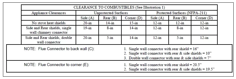

jeff_t, if you look at the clearance tables for the 30NC in the manual you'll find they list NFPA guided clearance reductions.
