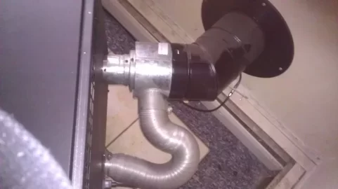

Do not try to get that stove running.
Sounds like you have a fried control board.
Likely other problems as well (possible over temperature operation related).
That #2 light should have stopped any pellet flow unless someone bypassed the vacuum switch.

Is the stove new or used? If new it is under warranty. I would unplug the stove for a bit and see if the board will do a hard reset. Plug back in and listen to see if both fans come on, if so see if it starts normally. If not unplug and call your dealer

With all those power surges?? Did you have a good surge protector on it? (Not a cheap strip model).
I hate to say it, but Smokey may be right. A faulty controller, fans and augers not operating as they should??
Edit: If it was the vacuum switch as you asked above? The stoves auger wouldnt have fed at all. Although the vacuum hose should be cleaned regularly. That is not your problem.
I agree with bear board is toast! Plus the convection blower probably got overheated and will also need replacing! Or at least getting its motor bearings changed.
If the OP didn't have a surge suppressor, The warranty could be null and void. I have heard of some dealers say nada to electrical claims due to power surges. Might have to post a claim to the homeowners insurance policy. Just saying and I could be wrong.
