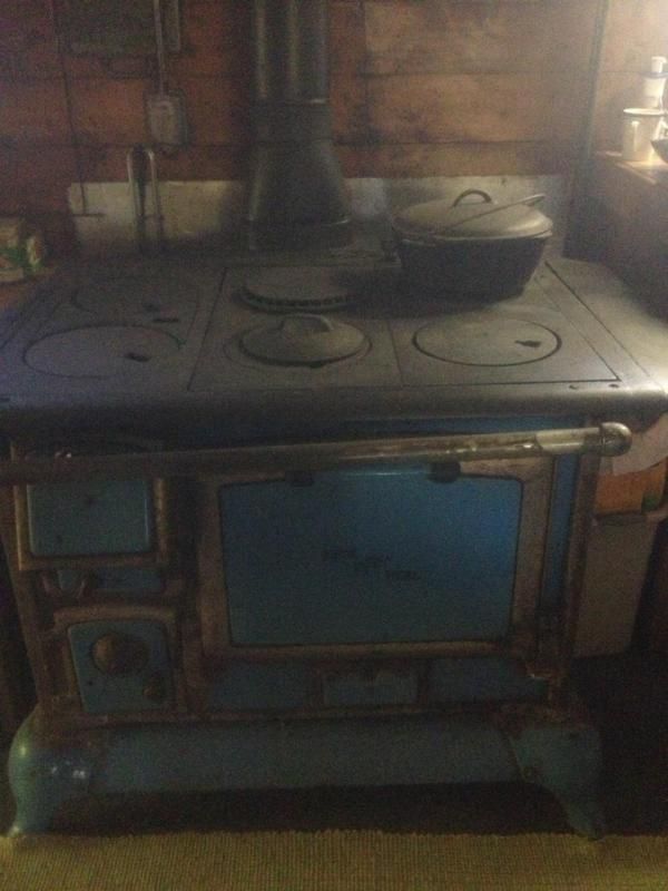

    PS: Can you post a picture of the Quick Meal?

    begreen - thanks for the welcome and taking time time to write a recommendation. I'll be sure to take a look at each one. Much appreciated. As far as the Quick Meal I'd be happy to post a pic. But it wouldn't be for a few day or maybe even 10-days as the cabin is two hours away from my
    permanent location. I honestly believe the original part of the cabin was built around it.

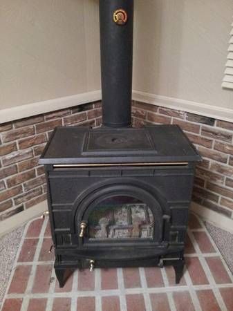

    I got a chuckle out of fossil's comment. Ha. Englander recommendation looks really good. Did some research on it last night. Also found this stove on CL last night but I don't think it's nearly as big as I need. Anyone have an idea of what brand of stove?

    Old Consolidated Dutchwest cat stove. Run the other way.

    I deleted any thought of the cat stove right away BrotherBart. Thank you for the help.

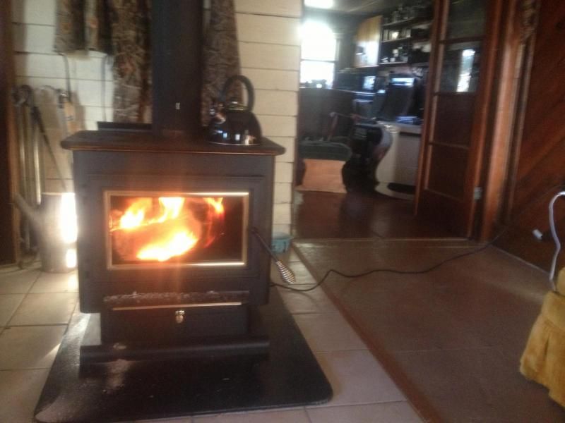

    Ok. I finally have pics of the old QuickMeal as promised (not porcelain although) tin? Also, thank you for the Summers Heat recommendation! We love it! I could have went bigger for a quicker warm-up of the house but the model we purchased at a discounted prices is perfect. Holds a burn for a long time with three year old seasoned ash split wood. Thank you very much from my whole family!
