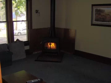

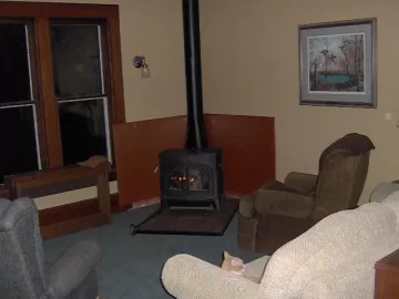

Well, I am still working on getting my 0028 Defiant Encore fired up.
The stumbling block I am up against is this, The owners manual I have for my 1986 Vermont Castings stove states... Do not use double-wall chimney pipe with this stove. Is this valid for today's double-wall chimney pipe or was this directed to some old 1986 chimney pipe that was not yet developed for this stove that may have been ahead of it's time?
From what I can tell from reading posts on this forum and others I have talked with, would be that the owners manual is gospel for the approved installations.
I have purchased Duravent DVL double-wall chimney pipe and a 8" oval to 6" round adaptor for my installation because the existing chimney pipe I had in place was 6" Duravent HT Plus class A chimney.
On previous post I first questioned the use of a 6" stack when VC manual and stove state to use only 8" pipe for this stove. Most agreed 6" with 20' + of chimney would not be a draft issue or burn the place down.
So; I have inquired with the manufacturer of the chimney pipe at Duravent... they had never heard of such a requirement or restriction. They suggested contacting VC, so I have....
No Answer for the last week and a half....
I think I am more than safe with this install 17" + from stack to the wall. I also have a factory heat shield for the stack.
Will my inspector and insurance company think the install is approved without the VC tech monkeys getting me the info I need? How can I get them to get me an answer? Does anyone know someone that knows someone that will help me?
Should I just use single wall?
Just want to do the right thing and not have any future hassle's
