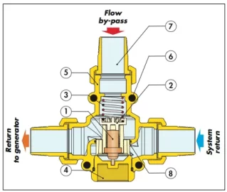

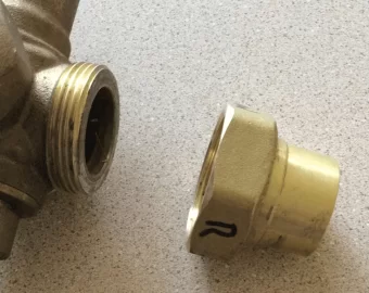

The valve has union connections, pipe it in, loosen unions, remove valve, solder, and re-assemble. Same with the NPT version, which has male NPT tailpieces instead of sweat..
No need to take the valve apart.
