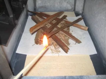

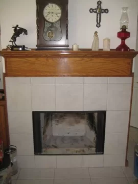

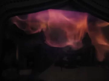

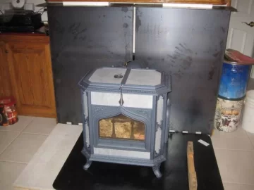

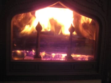

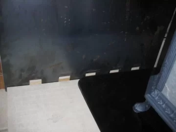

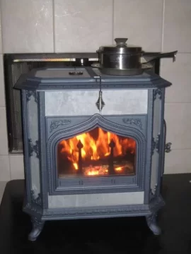

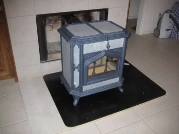

Here's a look at the installation and the first burn--now going on 30 hours. Last photo is at a WS thermometer reading of just over 600. I borrowed our heat gun from work which reads surface temps. The temp on the glass just under the apex of the window is/was 654 just a few minutes ago. The flue pipe read 500.
The photos show the original FP site, the stove placed, the first (and only fire so far) about to be lit, the view through the window (that's Lynda's supper heating up in the pan), the 16 gauge wall shield I picked up today dry fit behind stove, the vent holes at the bottom and the fire (cat in/damper @ 1, then cat in/damper @ about .75) showing a curtain of flame in the top 1/3 of the firebox--when the wood doesn't look like it's burning at all! A little spooky, eh!

Congrats! Fine looking stove and fire.
Sweet, we have heat!
How did the liner installation go?
Good going! Love the burn pics best!

The stove has run for about 48 hours now and had a max of 650 for about 4 hours. Y'think anything might have been damaged? It's cooling off now 'cause I have work to do on the chimney cap. That secondary burn stuff is intriguing. It's kind of hypnotising if you're not careful, at least I thought so. I laid down on the floor and looked around in the firebox with the hand torch and found the grill work where the smoke goes up into the cat (I guess that's what it is!) and it was glowing a fairly bright red. The top flame seemed to range from a dull yellow, to orange to blue and looked like an aurora and seemed to be there when the wood below didn't have an active flame.
I sure hope this stove is large enough. This initial burn has not helped to figure our need for heat yet , but in the connected/open aeas it will really run the heat up. It's the overall square footage where I think it will have trouble producing enough heat for us to circulate and keep it reasonable. That's where I anticipate the mass and output of their new stove to make the difference. My guess is that when the OS temps fall into the 20s and remain there, the stove will struggle to maintain the house at 65-70, but we shall see.
BTW, the wall shield will be painted the same color as the stove frame.

The thing that worries me about your initial burn is that the mortar and stone have moisture in them and if you heat it up to fast and hot it may crack or break if the moisture creates pressure. A scary thing happened to me on my 2nd break in fire, A chunk of soapstone about the size of a quarter popped out the side stone inside the fire box. I heard a loud pop and looked inside and saw the hole and chunk of stone. Thankfully it didn't pass all the way through. You may be fine since you brought it up slow, but I'd inspect the mortar seams and stones inside the fire box.
Remember this stove is a space heater and you won't have even heat through out your house, it will be hotter in the stove room but fans sitting on the floor pointed towards the stove room will help push that cooler denser air towards the stove and force the warm air to wrap up around to replace it.
That ghostly flame sounds typical of a low burn and is the most efficient burn for this stove. Take it easy and figure the stove out, there will be some trial and error.
