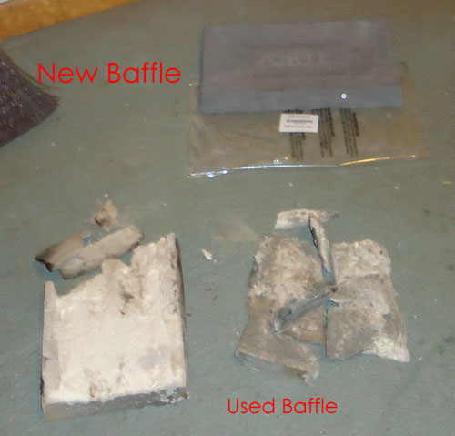

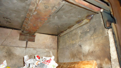

    I've got a Napoleon 1402 wood burning insert, with similar issues. The baffles seem like styrofoam and were completely destroyed after about 6 months:
    [IMG]
    My solution was to have someone build a 3/16" thick stainless steel baffle using the Napoleon-designed ones as a template:
    [IMG]
    Full write-up here:
    Full article / review of Napoleon 1402 insert

    This sounds like premature failure. I don't recall other users running into this. Did you discuss the issue with the dealer or was the stove run pedal-to-the-metal last winter?

    I am trying to piece together this puzzle because I know of Napoleon 1400's that have gone years without seeing this issue. The common thread so far appears to be that both of these issues are showing up on stoves in uncommonly cold climates. But perhaps there is something else?
