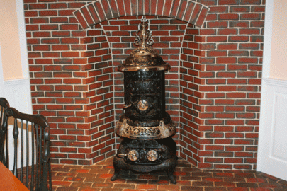

    Well after 6 months of working every single night until late and every weekend day the addtion is finally done and the smoke dragon is installed. Just a few more connections until I can fire her up and let her belch. I had to put an addtion on the house. I went as far as putting steel beams in the 1st floor with an 8 inch concrete slab over the basement full of steel rebar with brick over that. All the back walls are layers of 4 inch block with air spaces between each layer so completely non combustible. I did every bit of work myself including , sitework, basement foundation and floor, masonry, framing, roofing, siding and trim, interior trim, drywall, painting, finish work, hardwood floorring, stove work, masonry chimney etc. After many thousands of dollars and hundreds of hours I am complete. Here is the finish photos of the old dragon. I even built all the furniture for the new room but thats another story. No secondary burn tubes and no catalitic action. She was built in the 1890s. we just restored her. I dont expect modern stove performance but I do expect lots of heat. I have plenty of wood Whew!!

    That is sexy as hell right there. The stove, the arch, the hearth- wow!
    You might look into one a dems in-pipe catalysts that might help with creosote and smoke.

    Thanks, I did look into the in pipe catalyst but we dont have the room for one. The distance between the connection on the back of the stove and the the opening in the brick at the thimble is only 3 inches. And I have to fit a manual damper in that area. My wife was adamant that she did not want any stove pipe showing. She does not like the look of stove pipe for some reason. Therefore I designed it to go right out of the back of the stove and into the wall asap. I have very dry wood and will burn it hot and control temps with the amount of wood to keep creosote down. I also have an easy set up to clean the chimney from the basement so I will clean it often.

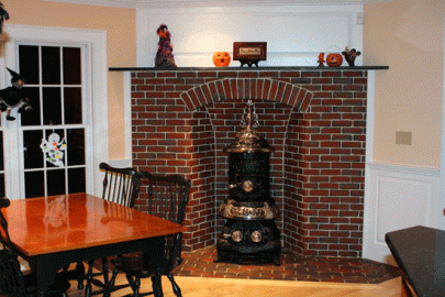

    Is that mantle stone, wood, er; non-combustible?
    Well...what's the mantle made of? (C'mon Granpa...spit it out:))

    Soapstone. Cut it and installed it myself. We wanted wood but I would never put wood that close. It will get way too hot. It overhangs about 5 inches

    [quote author="ScottF" date="1223669770... We wanted wood but I would never put wood that close. [/quote]
    Yeah, that's what I was gettin' at.
    The soapstone is an ingenius idea.
    I sometimes worry a little about non-combustible mantles. Folks have a tendency to place combustible items atop them. In my case, a birthday card blew down (thanks to the ceiling fan) and fluttered down, landing right on the stovetop, as I watched it. (No exageration.) Needless to say, I corrected that problem right away.

    Thanks for all the positive comments. Its not completely hooked up until tonight . I have to make a custom connector. Was wondering if I should do break in fires? It has been burnt before many many years ago. It was all sealed so that may need to cure and the paint may or may not need to be cured. Any opinions. Scott

    Cast iron likes to be broken in. Start off with a small kindling fire to check draft and operation. Then build up each successive fire with a little more wood. If you have a thermometer on the stove that will help guide you. I'd break it in over say 4 fires raising the temp from 250 to 450 in 50 degree increments. And open a window, it's likely to smoke a bit for the breakin fires.
