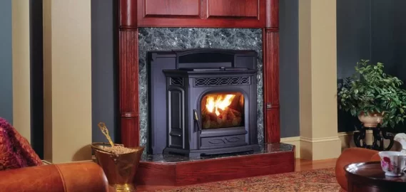

I have a tri-level - 2200 sq ft - pellet stove in our basement level (Harman Accentra Insert) and it heats over 90% of the house. I think 2 stoves might be overkill.
And it's attractive (I think more attractive than most wood stoves)

What is the temperature in the lower level and what is it in the upper levels?

well my first level (the basement level) of my trilevel is partly open to the second level (living/dining/kitchen) and then it's a normal set of stairs to the third level, which has a bedroom, a 90 degree turn, and then 3 other rooms.
my first level (with the stove) hovers around 72-74, but the thermostat is on a side wall, not in the flow of heat.
my second level has 2 thermostats - the kitchen thermostat is directly in the path of the stove blower and hovers at 74 degrees.
the living room thermostat - turn left and then turn right from the kitchen hovers at 71-72 degrees (partially due to a drafty door that needs replacing).
my upstairs - the first bedroom before the 90 degree turn is at about 71 and the very back bedroom (after the 90 degree turn is at 69)
And that's with the boiler supplying hot water only (no heat to the rooms).
I should draw a diagram, because since it's a trilevel, it's really chopped up and the airflow is minimal (like in summer, it's impossible to cool)
With your split level, you should be all set. You set the stove, and that heat will rise right up that central staircase. And since the heat wants to rise (and in a split level, has a nice path to go up) it will roughly even out.
Like in my house - the heat doesn't sit in the lower levels - it rises, and no one are gets too hot.
If I choose to crank it, I can get those numbers up. Also, when it's cold, I crank the stove and I can still achieve these numbers.
