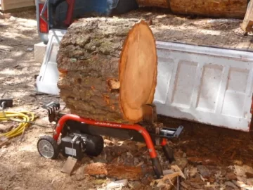

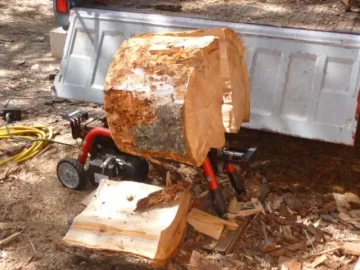

    At the risk of sounding like a broken record, check out the small electric splitters.
    Mine is a 5-ton Homelite, but there are numerous models under different brand names which utilitze the same motor/pump combination, including a 2-speed 7-ton unit from Harbor Freight.
    At $300 (Home Depot), these are little workhorses. They won't power through those twisted/crotchey pieces, but the judicious use of your chainsaw and an eye for the weak spot in a log will allow them to split almost anything you can handle. The round in the pictures is 25 in. diameter douglas fir.
