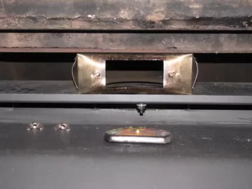

I’m having a problem with smoke pouring in the room every time I open the door. I love my new stove. It burns awesome. Puts out crazy heat, but something i did during the install is causing smoke to come in the room whenever I open the door. I mean tons of smoke.
I had a Napoleon 1101 in the same spot where my osburn 2400 is now. I have the same chimney liner and off set box set up that I had just last week with my Napoleon. But now I have smoke pouring in the room. No matter what is going on the firebox smoke pours in the room. Thinking it was a cold chimney problem, I tried opening the door with a 500* fire. Same thing -smoke pours in the room.
I just swept the chimney last week. I posted this question in another thread and didn't really get a reply so I'm re-posting it here hoping someone can help me out- hope that's not poor etiquette
One thing I did differently than before was while I had the stove out i insulated around the bottom of the liner where it meets the space where my damper used to be. Also I had to squish the offset box about 1/4" to get it to fit under the lintel. Here's a pic of the offset box. Any ideas of what I did wrong? I know there are gaps on the sides of the box due to me squishing it.
I've tried having a window and door open during reloads. Did not work. -I'm almost positive the baffle system is installed correctly. Thanks so much.
