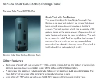

There are some other brands hitting the market, less expensive options. They are glass lined steel tanks with a conventional gas burner and a power vent on top. Schuco has one, Heliodyne does and a few others. I believe they are all US built with private labels on then.

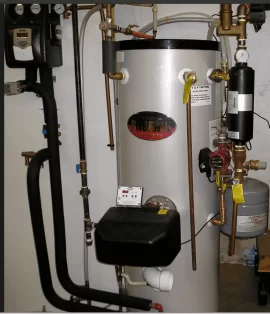

We have been data logging one for about 6 months. The burner is at the bottom but the control sensor is mid tank. The concept it to heat just the upper portion of the tank leaving the bottom 1/3 cool for the solar coil to warm. It does tend to heat more of the tank than we expected so it does limit the solar fraction. A bit of a compromise tank, like an SUV :)
It is intended for customers that do not have room for a dual tank solar DHW and lets them use gas or LP instead of an electrical element at the top which is typical of most solar tanks.
I have an HTP Solar Phoenix tank which has solar coil in the bottom and a condensing burner and HX inside and the burner and control is mid way up the tank. It modulates and condenses and if very fuel efficient. It's a stainless steel tank and fairly $$.
