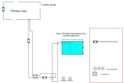

I have a Grundfos 15-58 on the cold side of a flat plate heat exchanger that isn't holding its prime (its pumping air). The diagram attached shows the design I am using. What it doesn't show clearly is that the HX and pump is at ground level in the garage. The tank is in the basement. I have the pump on high speed and the head is within the pump's capacity. Why do you suppose the cold side won't pump?

Are you saying that your open storage tank is below your (pump) and plate exchanger? If so....................
Its a circulator so it cannot pump air. Can only create suction VIA liquid. Whats stopping the piping from gravity feeding and emptying back into the storage if it sits below your pump? Having a check valve in your tank on the suction line side of the pump once primed may work. I must not be understanding your equipment placement VIA elevations.
:coolhmm:
Yes, the unpressurized tank (not really open) is below the pump and HX. Since the pump is running continuously in either charge or recovery mode, a check valve is only used at the pump. The Grundfos 15-58 comes with one installed.

A charging assembly on the outlet side of the pump is necessary. You need to be able to positively push all air out of all
the pump lines. Since you have all this extra stuff with the four way valve, it could be that some air is lurking in one of those loops.
A charging assembly is a boiler drain and a shutoff or two, depending on the location. This ensures that the water is pushed in the right direction. It sometimes takes
a couple times to get all the air out.
You do need to have some excess head capacity beyond whatever the loop is to help prevent cavitation.
The circ is trying hard but the water isn't getting to the pump. I loosened the pump flange and can hear the air escaping. I keep thinking that water will follow the air, but it doesn't. I put a T under the pump at one of the cold outlets of the HX. Into that connection I inject water from the domestic water supply. That supplies the pump with water for a short time. I also put a T on the other cold water port of the HX for bleeding out air.
Your plumbing is a little more involved, so you will have to push all the air out of both lines that go into the tank.
Both ends in the tank must be submerged.
Do not install any air vents since they will not work the way you want them to. The lines that go to the pump are sometimes under pressure
and other times under vacuum.
When you open the pump, there should be water coming out non-stop.

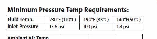

a circulator is not designed or intended to "lift" water or a fluid. It moves or circulates by lowering the pressure on the suction side and adding that pressure to the discharge side. I believe Grundfos recommends at least 2 psi pressure on the circ to prevent cavitation.
In a closed loop that would be in the fill pressure. In an open loop you need a column of water, not air above the pump to provide the pressure. Known a NPSH net pressure suction head.
I suspect every time the pump shuts down the water flows back down to the tank below, and the circ tries to lift the fluid from the tank, like a sump pump?
The pump will rust and corrode also in that application as it will see a constant supply of o2.
Any way to use a heat exchanger in the tank and build a closed loop pressurized system?

A circulator will usually work in this type of installation, if properly primed and if it is low in relation to the height of the water in the tank.
We have done a lot of these types of installations as solar drainback systems with good results. It is critical that the pump is primed--no air in the loop and no
leaks in the plumbing, and no air vents that can leak air into the syphon tubes that go in and out of the tank.
