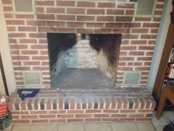

As many of you know I have had a lot of topics and posts on the install of my Englander 13NC stove over the last couple weeks. I finally got to burn it last night and I realized it is just not going to do the job I want it to do with the way my house is setup. I am going to be retuning it this weekend to Home Depot and I am going to be purchasing another insert (previously had an insert). I am definitley going with a larger size firebox this time. I am really dissapointed too because I love the way the 13 looks inside my fireplace. I just have to make a decision before I can't return it anymore and i know I won't be happy with it in the long run. Please see my other thread and give me some insert recomendations!
This coincides with my Englander 13NC update post. Long story short I just installed a 13NC in my fireplace and am not happy with it. I am returning it and going with an insert again. (Previously had an insert). I am upping my budget this time to $2000 for the insert. My firebox has the following dimensions, 33" wide, 28" high, and 24" deep from the center of the front to the back wall. The width of the back of the firebox is about 22â€. The walls slope in pretty good from front to back on the sides. (Included is a pic of my fireplace opening.) What is the largest size insert I can get in there for around $2K or less? I will be extending my hearth out. Thanks in advance and sorry for all the posts/questions!

How big is your house? Open floor plan? Insulation? Windows?
I have about 1500sq ft I want to heat. It is a bi-level so the fireplace is in the basement. House was built in 87 and is insulated fairly well. Windows are older style Anderson but are in good shape.
What about the Napolean 1402 series insert? Would that be a good choice? Would it fit?!?!

I am thinking so too. I want to be sure this time though. The measurements look good in terms of fit? Also is the Napolean a N/S burn?
Yeah, it should fit no problem. You've got a pretty big fireplace. Do you have a centrally located staircase? This would help distribute the heat evenly throughout the house. My staircase is located on one side of my raised ranch. One side of the house gets hot. Because I have a one year old who gets into everything, putting fans on the floor isn't really an option.
