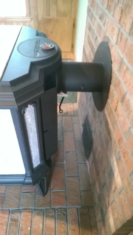

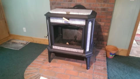

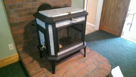

Just an update on my parents' new stove. Some of you were following the thread where I posted a question about which rear-vent stove would be best for him. Lots of ppl wanted me to post follow up pics once it was installed.
Woodstock builds a quality product, let me tell you. This thing is solid. Fired it for the first time last night and really enjoyed it. Beautiful burning stove with the flame show of the secondaries burning and the cat working in the guts of the stove. Very cool. Here's the install. I'll try to keep you abreast as to dad's learning curve. After burning the old Fisher for 24 yrs he's certainly in for a treat!
Thanks for the update. It looks like the Progress is right at home there. I have one concern, though: Have you checked the manual whether you have enough hearth on the loading side? That looks a bit short there.
IIRC, it's 18 "
They DO NOT have enough protection and will be installing floor protection before burning season.
