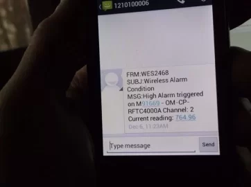

Yes, my phone just texted me. :cool: I read you post yesterday and decided to see if i could get the text notification on alarm function working in my Omega data logger.
I have a OM-CP-RFTC 400A transmitter and a OM-CP101A receiver. These are older obsolete models that work with Windows XP.
It took some time to find a SMS gateway for my provider and get all the email settings to work, but I just got it working now.
I can set a high and/or low alarm for stove top and a high or/low alarm for ambient temp. The software will send a text notification to my phone on alarm.
