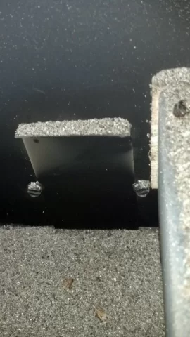

    Does anyone know what the two metal squares do in the fire box of a uss 5502 are for and should they be tight or loose ? Mine were loose from new and I tightened them ...

    can you post some photos? that would help

    There is one on each side of the burn pot base ....

    Looks just like my breckwell, access to clean behind firebox

    Ash trap clean out ports.
    Keep em tight and closed when burnin'

    Thank you! Thats what I thought they were . My harman does not have them and was a bit confused . Do you have a comparable model to the USS KING 5502M?

    Yes they are ash clean outs, keep'em tights and clean out behind them regularly. I find it best to have a hose attachment for your shop vac/ ash vac.
