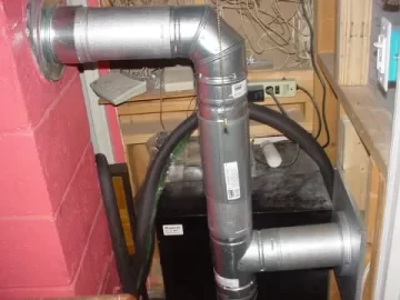

    I adapted my stove into the existing 8" woodstove pipe:

    Now is that just black single wall pipe? Or is it regular pellet stove pipe, painted, with an adapter to the factory built chimney?
  5. imacman Minister of Fire
    It's regular 4" pellet pipe with adapters to mate with 8" double wall stove pipe.
