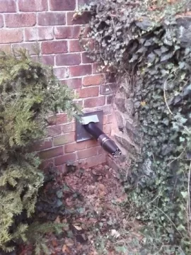

Our Accentra FS was installed about 3 weeks ago by the dealer. The venting is horizontal, save a low degree of pitch between thge stove and the thimble. Should I be concerned about this?
Interestingly a friend I haven't seen in a while who has 5 pellet stoves between his two houses, alerted me to the vertical venting issue the same day this thread was started. The Harman book that came with the stove is clear that vertical is optimal, but the dealer still says not to worry. Now I am not so sure.
Obviously it would not be a big problem to rework the venting. Should I?
If I had any idea how to insert a photo here, I would.

As always, hat tip to Smokey. I will work on the photo.
If this works, then the pic is of my exterior vent set up.
Well how about that!! Thanks again to Smokey. Now that you all can see it, comments are welcomed.
I thought so too and asked the installer about that. He said it was fine, and he is probably right (the perspective might distort the distances in the photo). I say he was probably right because the stove has been running since 10/24 and not even one leaf has curled up and died from the heat. But we will watch to make sure the ivy and such does not grow too close.
Those dried leaves seem pretty close to the termination in that pic.
We removed the leaves the day after the pic was taken, which was the day of the install and before the stove was turned on. Some keep blowing back, but my 15 year old son has been detailed to check every day and make sure we are clear.
