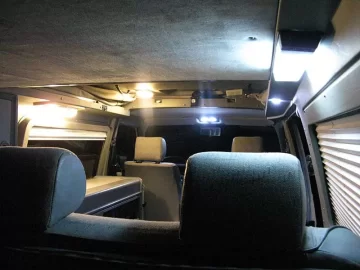

Here's a lighting comparison of 5000k LED interior lamps (in front and on right) and the 3000k LED Ming bulbs (on the left).
Thanks. Hard to tell too much from the picture, but it sure seems like the 3000 ones don't have th yucky greenish tint I've seen on so many cheap-o LED bulbs.
