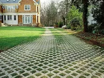

Maybe look into grass pavers?
(broken link removed to http://www.paversearch.com/grass-pavers-menu.htm)
  • [Hearth.com] Water Permeable Pavement
We used these in a large-scale building project last year (I think they were a LEED point). Downside is you have to mow them obviously.
