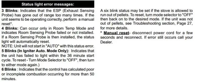

    I am looking to see if there is a web site or a link that tells what the Blink codes are in a Harman Accentra Insert? I dont have a problem with my stove but just looking for Info. thanks

    Here ya go!

    No problem. I figured if some one Google they would get this thread and having the info here(hope its correct) would be a plus for someone.

    I have the downloaded manual and I did not see this in there. Thanks for the post. My FS Accentra just went down yesterday for the first time this season, (been running since early December) and I saw 5 blinks only. My version of the manual mentioned the fix for a six blink code. After her first cleaning and a vacuum of the exhaust as well as the ignitor area, she started right up again. Gotta love that Harman!!!!
    Again, thanks for the code posting. :cool:
