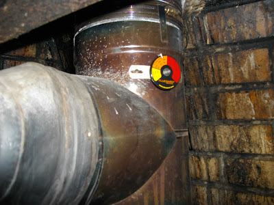

    my t is double wall and I have a probe in top of the t. I have to be carefull when reloading as if air is wide open the ss double wall liner will glow and probe shows 1300+ if I forget to watch. I just don't keep air wide open until the cat is engaged then I open up for few minutes.
    [IMG]

    The Tee in the picture is single wall.

    This is just what mine looks like, but the therm is actually just on the outside attached by a wire - no probe inside.

    Then you have a Stainless Steel single wall Tee just like the one above. (I hope your stovepipe isn't backward like the one above) The temps that you experienced were normal. it's good that you remembered the stove though!
