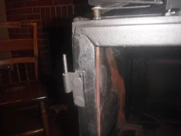

Finally got to take pics. Full size
Reduced. The oval marks where the core shifted or was cracked. You can't really see it but above that line the metal is 1/16" - 1/8" higher than the rest. This think could *never* have sealed correctly.
Even worse is when I pulled the hinge. The discontinuity goes through the hinge pad as well. The original finishers hit it with a grinder, but they only flattened over each screw hole, so the pad is still uneven. <> I broke out the Dremel and chased the ridges down. It was worse than I thought (of course) - they weren't solid but had actually formed cold shuts, so I had to go about 1/16" into the base metal to get rid of them. :mad:
