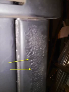

What causes the paint to wrinkle when painting a smooth steel stove?
See pic
Usually happens when you spray a solvent based lacquer over an enamel painted item.
Impurities on the stove prior to painting, overfiring (hard to do on a pellet stove), Applying coats that are too thick or not allowing flash time between coats.
Probably faulty or inadequate surface prep prior to painting. Also their may be a conflict with the formula of the two paints. Not really enough info given to make that determination.

I did wire brush the area and used a 1200 Degree F Stove Paint. Most of the stove painted up fine just a few pots had wrinkle.
