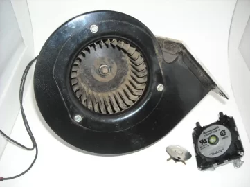

    Just had a fun time on this stove. See pic!
    See 3 parts below and guess which stove they came from and what did they have in common?
    Hint: The blower mounts with only two bolts because the back side goes into a flange.

    No idea about the stove, but they have convection air movement in common - blower, vac switch, POF snap disc.

    Good guess, because they all failed at the same time!
    The convection blower was so loaded with dust, the bearing ceased and the motor over heated so the blower motor's thermal circuit kicked out. Then because the hot air was not being pushed out of the stove, the stove overheated and the Hi Limit switch blew! The switch could not be reset, then the vacuum switch got so much hot air that it was fried also! They all had to be replaced to make the stove run normal again!
    Now maybe someone can guess the stove?

    The clue would be the honeywell vac switch. I have only seen them on an EF2 /EF3
    So I'd say Enviro EF2/EF3,
    You are correcto mundo Jay! It is an EF-2i purchased on sale brand new for $1200 ! ! !
