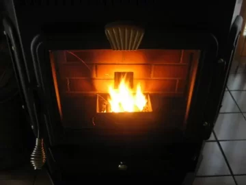

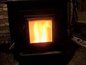

    Smitty, here's a pic of my 10-cpm burning on medium heat (5). 2nd pic was from my Astoria.
    Similar flames from both, and I think they are just right.
