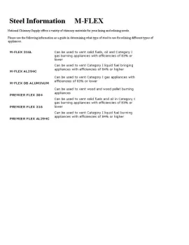

Cozy heat, I think your mistaken. M-flex .006 316L, National Chimney Supply Inc. Less expensive than 316ti. Paid for 316ti, got 316L. Is it your stance that it's OK to bait and switch?

Well, I'm a little fuzzy on how I am mistaken in posting facts and asking questions. But since you've identified the actual liner and manufacturer, I took a look at their web page:
(broken link removed to http://www.nationalchimneysupply.com/MFlexLiners.aspx)
Our M-Flex liner, available in 316L/316TI Stainless Steel is designed to reline existing chimneys or be used in new construction. Manufactured in the highest grade mill certified alloys. ...
They do make this read a bit unclear. Generally the way these are made is the actual liner is 316Ti and the additional components - cap, banding, clamps, T's etc are 316L - hence the 316L/316Ti designation.

Now maybe I've been unclear. I purchased a liner from a company that advertised it as .006 316ti , the components are forever flex, olympia chimney supply. Competitor sells advertised .006 316L M-flex for less. My liner Has a UL sticker saying CB M-FLEX national chimney. I see nowhere on their website that they offer 316ti
316L does come in.005 and .006 and thicker on the heavy flex. At this point its not a matter of is it OK or did you get a better deal which this gentleman did not at .006. This is a clear case of misrepresentation. Robert give this reseller both barrels, because lets face it your not the only one this has been done to and you can help making it the last. The guy saying that there is no such thing as a .0063 316L is totally mistaken, .005,.006 liners are made in 316Ti, 316L, AL29-4C and 304L . We manufacture Flex King Chimney Liner System
