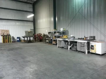

    "iron mike's ironworks" as i have dubbed my little corner of the new ESW facility its not usually quite this clean but i abhor a dirty shop.

    Very Nice Mike and really Huge! That has a high ceiling, is it hard to heat in the winter?

    believe it or not its heated with the exhaust air from our compressor dryers. we use a crapload of air in what we do and the air has to be dry so we have these big dryer units which remove moisture from the air in our system (i dunno how it works) anyway the byproduct is a boatload of hot air, in the summer its ducted outside and in winter inside where it keeps the entire plant relatively comfortable in the winter. we have to run the dryers (especially with an air driven paint systems) so the heat we get from them is a relative "freebie" i mean its not 75 inside when its below freezing outside , but its usually at least 60 ish so a light jacket on the floor is quite comfy but not a necessity.

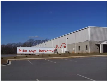

    built a basketball goal we lift up on a forklift for a bit of lunchtime shooting, but yeah its plenty big enough 175Ksq ft
    here's a look from outside
    [​IMG]
    i featured the "south plant" our new facility in tis thread a while back;
    http://www.hearth.com/talk/threads/got-stove-woodstove-porn.77865/

    this shot gives a better idea of the sheer size of the place
    http://i275.photobucket.com/albums/jj307/stoveguy2esw/100_3135.jpgif ya look over the front of the semi trailer you can see the class a flue mounted in my test trailer (a modified reefer trailer i use to burn both pellet and wood stoves) its literally 75 yards past the trailer in the foreground. was a bit pricy to install as you can imagine the height needed to be able to get out of the effects of the higher roof. surprisingly it drafts relatively well if i drop the roll up door at the dock otherwise the exhaust fans from the plant can cause back puffing

    looks like you have a little graffiti problem:)
