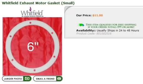

    Hello
    There are basically 2 sizes for Combustion Blowers - Small 6†or Large 7â€
    So for my Avalon Astoria Large Size Stove, the Combustion Blower is the Large blower Gasket
    http://www.stove-parts-unlimited.com/Combustion_Motor_No_Housing_Large_p/10-1111.htm
    To verify this will fit see the Travis Part # in the above link = Travis #93005535
    This 7†Combustion Blower will fit:
    * Yankee FS & Insert
    * Avalon Newport FS & Insert
    You can also measure the gasket on your Lopi combustion blower as a final check.
    Here is the 7†Gasket for $12 but if you shop around you can get it for as low as $9
    http://www.stove-parts-unlimited.com/Whitfield_Exhaust_Motor_Gasket_Large_p/814005016.htm
    Here is the 6†Gasket for $11 but if you shop around you can get it for as low as $8
    http://www.stove-parts-unlimited.com/Whitfield_Exhaust_Motor_Gasket_Small_p/851002016.htm
