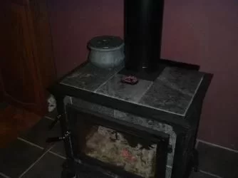

Ed's right, the stove top center stone can be heated to 525 or 550 with some effort and this is the only way to get the max output from these stoves. You don't leave the primary air shut off to do this, you load it up to the roof and run the stove with about a half inch of primary air.
I do burn softwood, doug fir which is better than pine, and have a vertical 14' stack with no damper. I have a condar flue probe meter (new this year) and a rutland stove top meter that I hope to replace with a condar inferno this Xmas. They just look better and I like the company.
Our stove's are rated to run up to 600 degrees and you're not seeing the potential of this heater if you don't push into the 500s when needed. Normal burns on normal days I set the stove to cruise at 400 or so which is done with a shut down primary air damper. This day I needed to gain 20 degrees in the house as quickly as possible so I burned it hard.
The stove is much cleaner on the inside after a run up to 550 or so. The deposits burn off quite nicely.

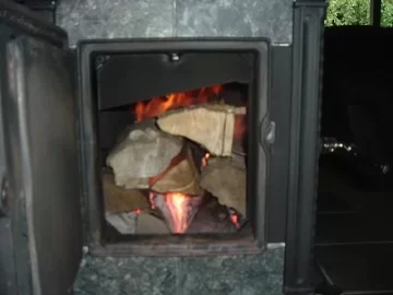

On edit: The pictured wood load is cottonwood (a great wood) but shows how you can load this stove when the F-around gauge goes to no F'n around.
