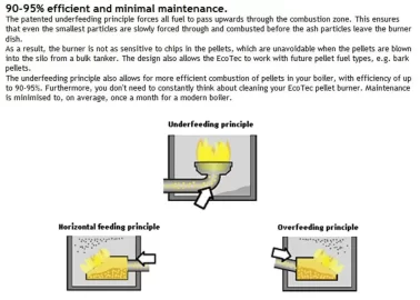

    According to this Ecotec website (link below) they claim that their patented pellet burner should have an efficiency as high as 90-95 % and that all other principles have a lower efficiency due to the fact that the pellets are not "allowed" to burn totally, since they are somehow turned into flying embers too soon by the violent dropping action. Especially the top feeders should be bad in this respect. The horizontal feeders like the Harmans and the Englanders most likely have higher efficiencies.
    Does anybody know the exact efficiencies for these particular brands?
    OK, when I compare the max. efficiency of 78% on my old Whit to the 90-95% claimed on the Ecotec burner we must conclude that a lot of fuel is wasted in my old Whitfield. Also, the heat exchanger is outdated and this contibutes to the overall bad efficiency.

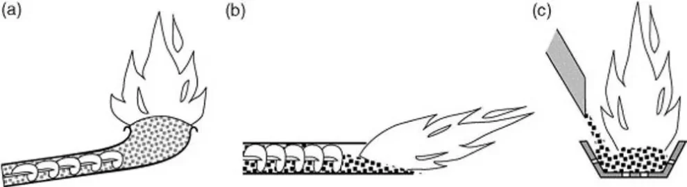

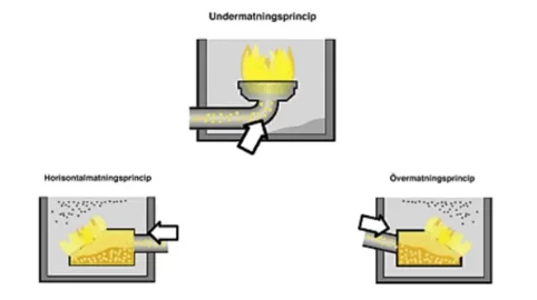

    On the photos below we see illustrations of the three basic principles that we're dealing with:
    Bottom, horizontal and top feeding.
    The patented Ecotec burner is the only true bottom fed type. From reading here on Hearth.com I've learned that the Harmans and to some extent the Englander pellet stoves are horizontal feeders, and that all the others ( the majority ?? ) are top feeders.
    Questions is: Why do so many manufacturers stick to top feeding when it's obvious that this principle has a much lower burn efficiency?

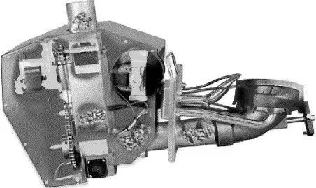

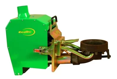

    Note: the Ecotec burner on the picture is from one of their pellet furnaces, but the Ecotec Tyr pellet stove has the same burner installed. It can be studied in the owners manual linked to below
    http://www.ecotec.net/pdf/Engelska/Tyr_instrbok-07_E.pdf

    And, I'm not so quick to believe the company's hype. They're blowing their own horn. If it was so great, others would be copying it, or coming up with their own versions.
    This thing looks pretty complicated, and I wonder if it's a servicing nightmare. There's lots to be said for simplicity, even if it's not the most efficient.

    DexterDay and the others are correct. Ecotec is talking 'burner efficiency', not whole stove efficiency. Smoke and mirrors and because of that, I wouldn't trust them without more feedback from users. Why is it obvious to you that top feeders are less efficient? I can burn for days with very little ash accumulating meaning everything else was turned to heat or byproducts. Therefore, 'burner efficiency, which you were discussing, is quite high. Now heat exchanger efficiency, as I have preached in the past, leaves a LOT to be desired sadly.

    This text below from the Ecotec web site must have gotten me hypnotized... now whouda thunk that I could be a victim of that so easily;sick
    "They're blowing their own horn"
    "Smoke and mirrors"

    Did anyone notice the "burn pot" angle on the illustrations? The top feed on the Elena drops the pellet into the burn pot from a distance of approximately four inches from the bottom of the burn pot. There is no angle on the burn pot as shown in the illustration...

    Thanks for noticing, Lake Girl. You're absolutely right. The illustration below is more correct. Especially 'c' the top feeder is more correctly illustrated here:
