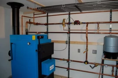

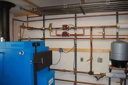

    Here are a few pictures of my piping,
    Initial piping used for 2 seasons,
    Upgrade this summer, parallel pump added for additional flow near end of tank charge, battery back-up, and or redundency if problems with top pump.
    gg

    GG, that has got to be one of the cleanest looking boiler rooms around.
