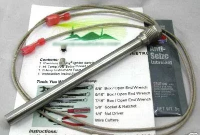

I am adding an igniter to a stove that did not have one. The tube is there and I am wondering how close to the Ultragrate the igniter should be? I have it working but won't light pellets. Any thoughts would be appreciated. Thanks as always

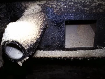

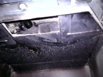

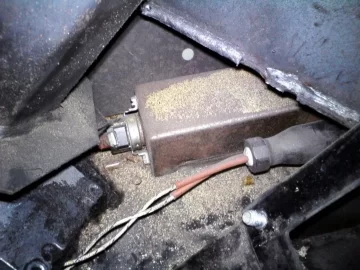

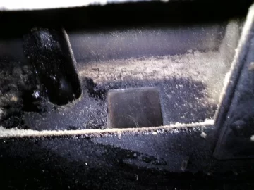

Your Advantage II T cannot be that different from my Quest Plus as for the igniter set up around the Ultragrate. I just found some pics of my igniter that I took a couple of years ago. From these pics you get an idea of the length of the tube next to the fire pot. Not the best quality, though ... took them with my cell phone.
Note: The convection blower, The Ultragrate fire pot and the ash pan have been removed for cleaning.
