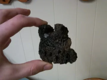

Here's a picture of a big almost rock like piece of ash that one my customers brought in today. I've never seen anything like it and just wondering if anyone else has? He said they are forming in his ash pot and want us to do something about it..

What you have there is whats called a clinker! And a big un too!
Ash fusion. Clorides(salt deposits) in the fiber fuse with the ash during the burn. Seems to happen more on higher burn settings as the temps get hotter in the burnpot.
Could you share the brand of pllets with us? These are the ones we tend to steer clear of. :)
That is sintered ash, aka a clinker.
clinker = temperature + ash (salt and mineral content) + time + moisture
Now if you can evacuate the ash from the pot there won't be enough time for sintering to happen. If the pellets ash production level is low there likely won't be the ash available, if the pellet has excess moisture (improper storage can cause this as can a poor production process) it will tend to assist the sintering process, if the pellet has a lot of salts in it the process is aided, if the ash is heavy (by weight) due to a high mineral content other than salt the process is aided.
So anything that effects burn air needs to be looked at.
Pellets storage comes into play.
The pellet is the single biggest contributer.
The fireing rate.
Enjoy they are really nasty things to have to deal with.
I just learned something new, I now know what a clinker is ;-) I see them hanging off my burnpot using the free pallet of NEWP's I got with the stove.
That' a baby clinker, you should see the ones my little castile stove can put out burning corn for 24 hours............

I should say mine are more like stiff clumps, not really rock like, they look weird hanging a few inches off the burnpot though.

I was getting those in my Napoleon's round cast iron burn pot about every 3 days while I was burning Canadian Energex. They kind of take the shap of a bird's nest. I run my stove between four and five and the air wide open. This year, now with OAK, I started burning MWP. No ash in my burn pot. Ran out of MWP so I started in on my Canadian Energex. This time only getting nut size crumb ash rocks. Got a new supply of MWP and no more clinkers, or ash build up in the pot. I get good heat from both.
