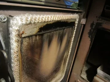

Please take a look at this picture.. does this seem abnormal.. I clean my window every 4 or 5 days.. clean exhaust and just did a complete clean out last week. Been burning firesides and hearth side this week.

not totally abnormal, but deposits will depend on cleaning, the pellet, and often the rate at which the stove burns (and since its not been to cold?)....I find more deposits at lower burn rates, commonly
