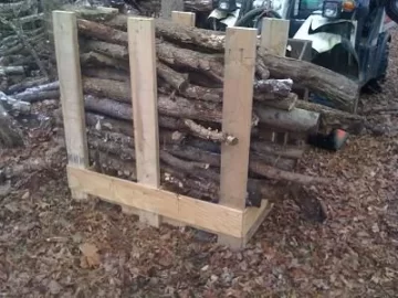

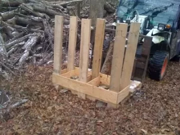

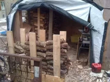

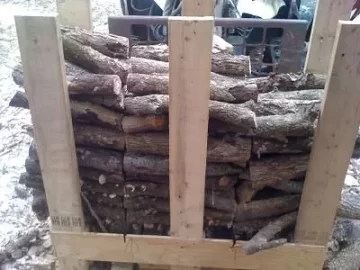

I built this limb cutting stand based on some pics posted here a couple of weeks ago. I can't find the OP but thanks for the great idea. I built this on a pallet base so I can move it easily with my Bobcat. I use a big round as a counter weight. I cut to 18" so this handles 6 to 8 foot material easily. It is 1 foot deep and 4 feet tall. I have about 30 - 40 Cords of material to process from clearing my land 3 1/2 years ago for the house and animal paddocks (about 2 acres). I set aside anything worth burning and chipped the rest. I load the material at the pile about 200 yards from my wood shed/boiler room and drive it over. I cut it at the shed and either use it right away or stack it. It is <20% MC and burns vey well in my boiler.
