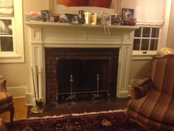

I've spent several hours today reading assiduously through all the relevant posts I could find on the forum, but I thought I would appeal to the collective wisdom and experience of the "community" for advice in order to reach a decision.
I'm in the market for a wood burning insert for the existing fireplace in the living room of our 3-story, 1912 (Mock) Tudor home located in Southeastern Michigan. I realize this may be a bit heretical, but I'm not actually looking to use the stove to provide regular or primary heating of the home; we rely on our furnace for almost our heating needs and tend to burn fires in the fireplace somewhat irregularly. My interest in an insert, then, is primarily to provide a little extra warmth and ambience when we're relaxing on winter evenings in the living room and not have the sense we’re just heating the outside air and burning wood for naught. The only other use would be in the case of a power outage, which we unfortunately have once every few years and at such times would be nice if the stove would allow us to hole out in the house.
Here are some details of the situation:
The fireplace is on a western-facing exterior wall in a living room measuring 13’ x 18'.
The dimensions of fireplace opening are 36” wide x 29” high x 19” deep.
The width at back is 26”
The existing tile hearth 21.5” deep
The inner measurements of the mantel surround are 52” w x 37” h (i.e., exposed brick on each side and above fireplace opening is 8”).
In terms of aesthetics, we would like something not too obtrusive and which would fit with the style of the home and room. In addition, we are leaning to something flush mounted or with a minimal projection, however, I have read here that fan noise can be an issue on some models (e.g., Osburm Matrix). Do all such models require a fan? Again, given that I'm not really seeking to heat the house, perhaps there's a reasonably efficient model that wouldn't require an electrical connection and fan…?
I’m attaching a picture of the existing fireplace. Please let me know your thoughts…and thanks in advance. [Hearth.com] Wood Insert

watch your Mantel clearances.....that guy on the Mantel may wanna pull his legs in a bit

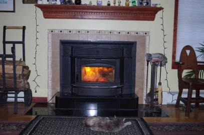

I am also in SE Michigan and just installed a Clydesdale at the beginning of December. My concerns with the hearth were similar to yours. I love the Clydesdale and find that it provides a very mild and long lasting heat probably due to its' soapstone lining. I strongly recommend it. This comes with an adjustable speed fan.
I had to extend my hearth and I didn't like the former hearth top so I took the opportunity to install a soapstone hearth top when I changed it. Love the soapstone because it absorbs heat while the insert is operating and then rediates it back when the insert cools off. This is a massive piece of soapstone 22 inches wide and 78 inches long. It weighs about 350 lbs.
The newly (2009) revised Clydesdale is quiet if you don't turn the fan up to a high setting. It can really throw some heat if you want to put a big load in it, or it can provide a gentle heat if you only want a moderate fire. Mine is installed in our finished basement (800 sq feet) and I can make the basement a balmy 85 degrees in a short time of I want to.
A note on your mantle surround - it is wayyyyyy to close for an insert. You will need to check the clearances before you put any insert in that fireplace. Each insert specifies the clearances to combustable materials above and to the sides. They all specify a clearance to the front (hearth) as well but most are a standard 18".

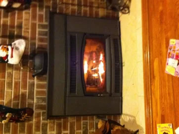

Get as big as you can. I bought a small one for part of my house and thought it was great....when I had an inefficient boiler in the basement below that part of the house basically heating the floor. Once I got rid of the boiler, best that insert could do wasn't good enough for me. Bought a bigger insert for my other fireplace and it can heat 2000sq ft into the seventies with no issue at all. Now I'm considering pulling the small insert and cutting out the metal plenum that's in there and putting in a matrix or another one of the Travis industries flush stoves. For ambient fire burning so looking to not waste heat, large viewing is what you want. I'd also avoid a cat or a hybrid if you're an infrequent burner. Adds a few extra steps to the process whereas a secondary tube stove is simply easy.
Here is my insert it a Travis industry lopi cape cod flush insert.[Hearth.com] Wood Insert
